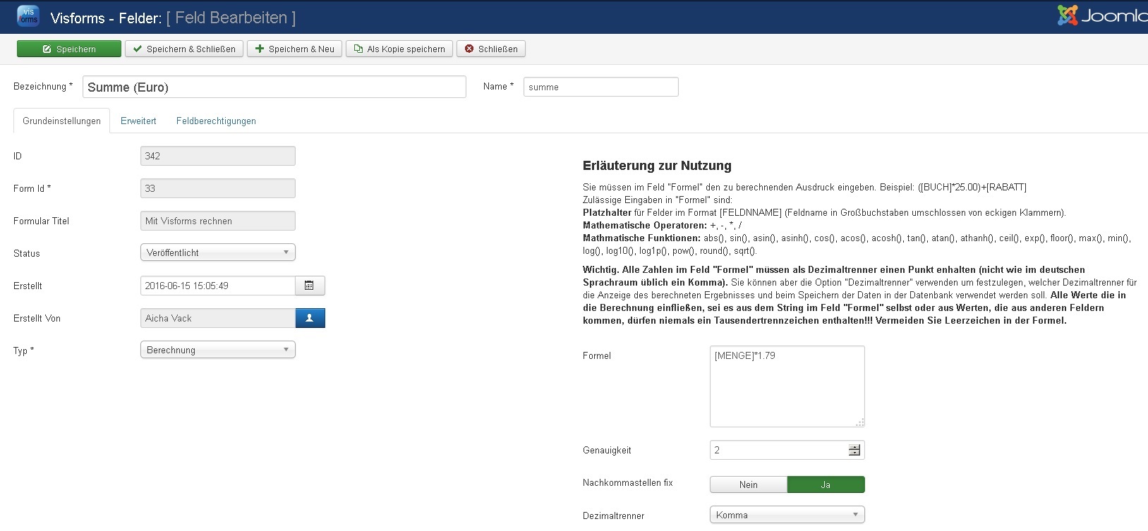

Fields of the “Calculation” type give you the opportunity to create a calculation formula, the result of which is displayed directly in the form. The formula is entered in the field configuration in a textarea. Also see the screenshot.
The formula can contain placeholders that represent other fields on the form. When the result is calculated, the placeholders are replaced with the values that the user enters for that form field. Furthermore, the formula can contain numbers, mathematical operators and mathematical functions.

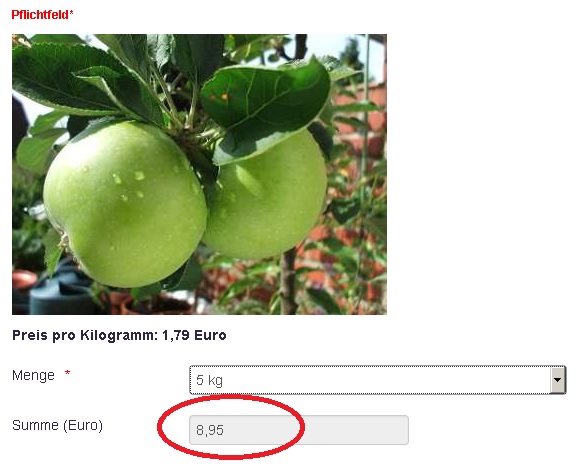

Field type calculation in frontend
Field calculation in the form
The result of the calculation is automatically updated in the form and is always displayed as a “readonly value”. As soon as the user has changed an entry in a form field that is included in the calculation, the calculation is performed again and the result is updated in the form.
