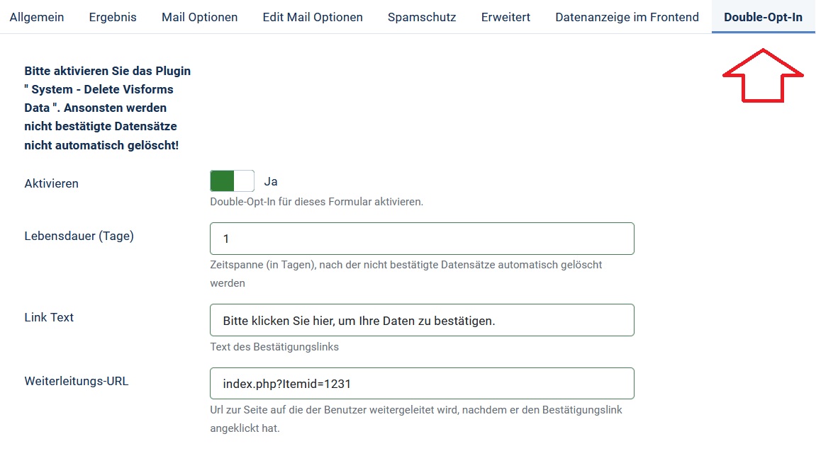

  • In the form configuration on the “Double-Opt-In” tab
    • Set the “Enable” option to “yes”.
    • Specify how many days the confirmation link in the double opt-in mail should be valid.
      1 day is a good value here.
    • If necessary, assign a text for the confirmation link in the double opt-in mail in the “Text” option.
    • Provide a complete absolute URL in the “Redirect URL” option.
      The user is redirected to this URL after he has clicked on the confirmation link in the double opt-in mail and the confirmation was successful.
Form configuration tab “Double-Opt-In”
Double Opt in Options
