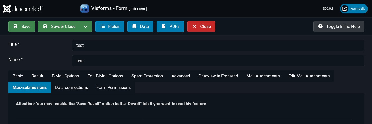

In your website’s administration panel, go to Components » Visforms and open the edit view for the form for which you want to limit the maximum number of submissions. Click on the “Maximum Submission” tab.
Form configuration

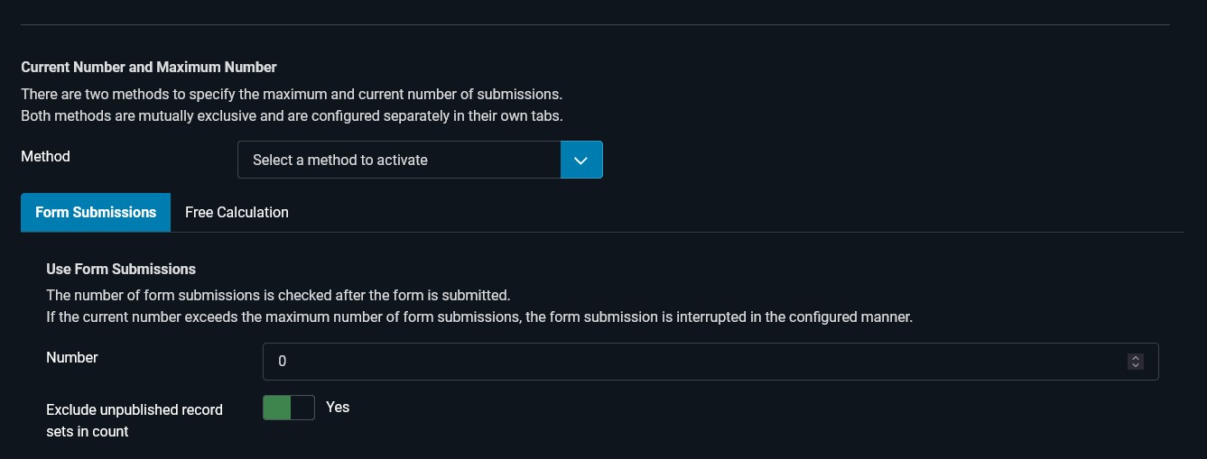

Form Configuration
Current Number and Maximum Number
In the lower section of the configuration, define the method for determining:
  • the current number,
  • the maximum number.
Various methods and options are available for determining the counts:
  • Form Submissions Method:
    This method is the simplest way to determine the counts.
    • Current Number: This is directly derived from the number of completed form submissions.
    • Maximum Number: This is entered as a fixed number directly in the configuration.

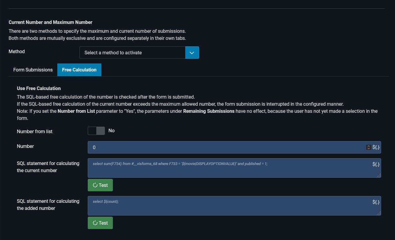

  • Free Calculation Method:
    This method offers more options in two steps due to its high flexibility in determining the counts.
    • Count from List Option = “No”
      In the first step, this method allows for a free, individual calculation of both the maximum and current numbers.
      This is useful, for example, if you don’t want to simply include all previous submissions directly in the calculation of the current number.
      This allows, for example, individual form options to have different weightings in determining the current number.

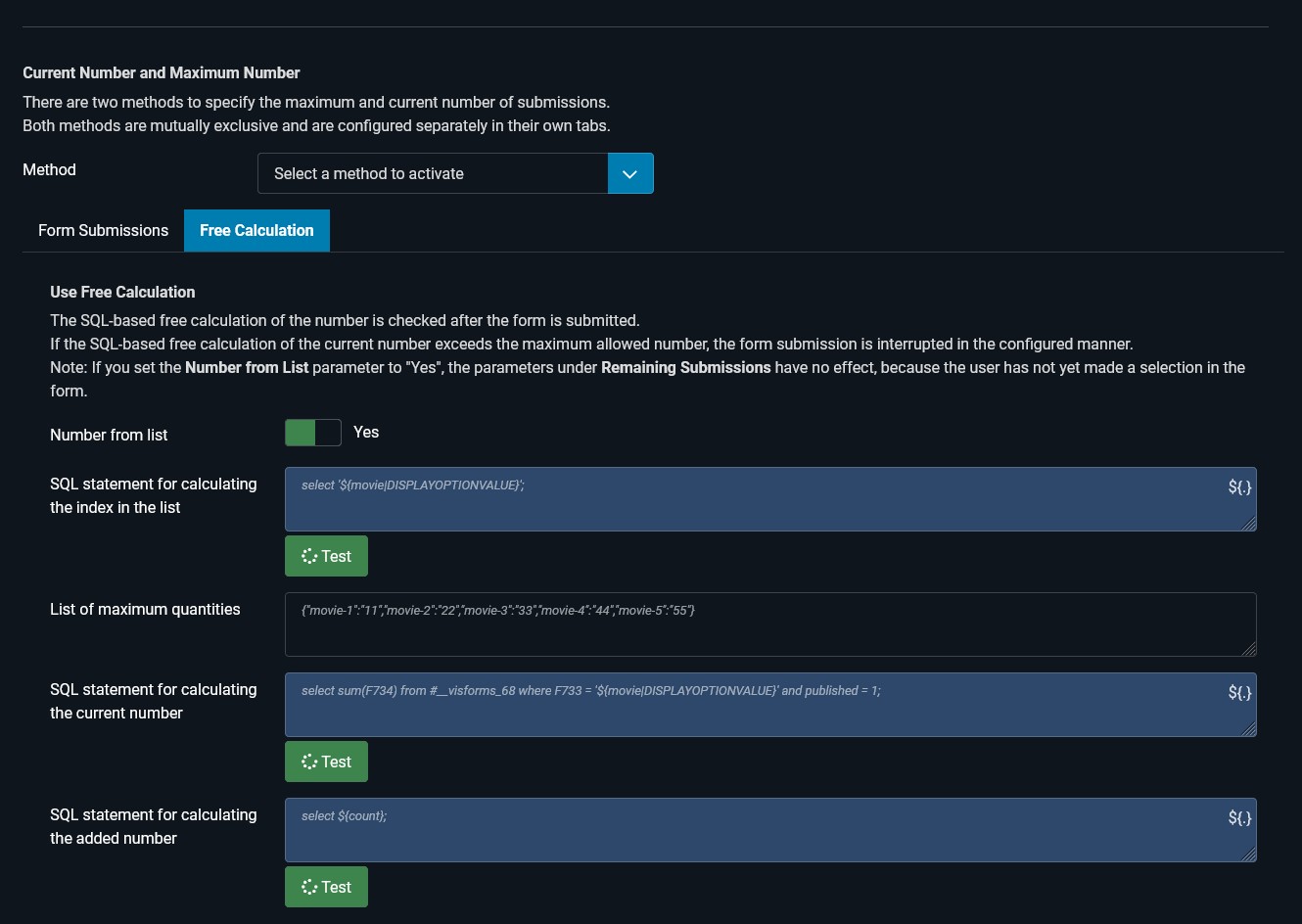

    • Option Count from list = “Yes”
      In a second step, this method allows any number of different maximum numbers in the form of a lookup list.
      This also allows, for example, different maximum numbers to be defined for individual form options.
Select the Method
Form Configuration
Method “Form Submissions”
Form Configuration
Method “Free Calculation”
The current and maximum number of submissions depend on the number of submissions made so far and therefore on the saved form data.
The described free calculation options must therefore access the saved form data.
For maximum flexibility in freely calculating the number of submissions, a custom SQL statement with direct access to all saved form data is the most suitable formula language.
Maximum Number is Fixed
This is the case for the following setting: Option Count from List = “No”. Form configuration
Maximum Numbers from a List
This applies to the following setting: Option Count from List = “Yes”. Form configuration

In the form configuration » tab Maximum Transmission, make the following settings:
  • Option Method = ‘Free Calculation’
  • Sub-tab Free Calculation » Option Count from List = ‘Yes’
Calculations
Note: Even the smallest deviations in the syntax will unfortunately lead to errors.
Then fill in the following options according to your use case:
  • Option SQL statement to calculate index in the list
    select'${movie|DISPLAYOPTIONVALUE}';
    The placeholder is enclosed in single quotes because it is a string literal in the SQL statement.
  • Option List of maximum numbers
    {"movie-1":"50","movie-2":"50", ...... ,"Film":"Count"}
    Name and value are each enclosed in double quotes.
    Name and value are separated by a colon.
    Name-value pairs are separated by a comma.
    No additional spaces are allowed.
  • Option SQL statement to calculate current number
    select sum(F734) from #__visforms_68 where F733 = '${movie|DISPLAYOPTIONVALUE}' and published = 1;
  • Option SQL statement to calculate count to be added
    select '${count}';
